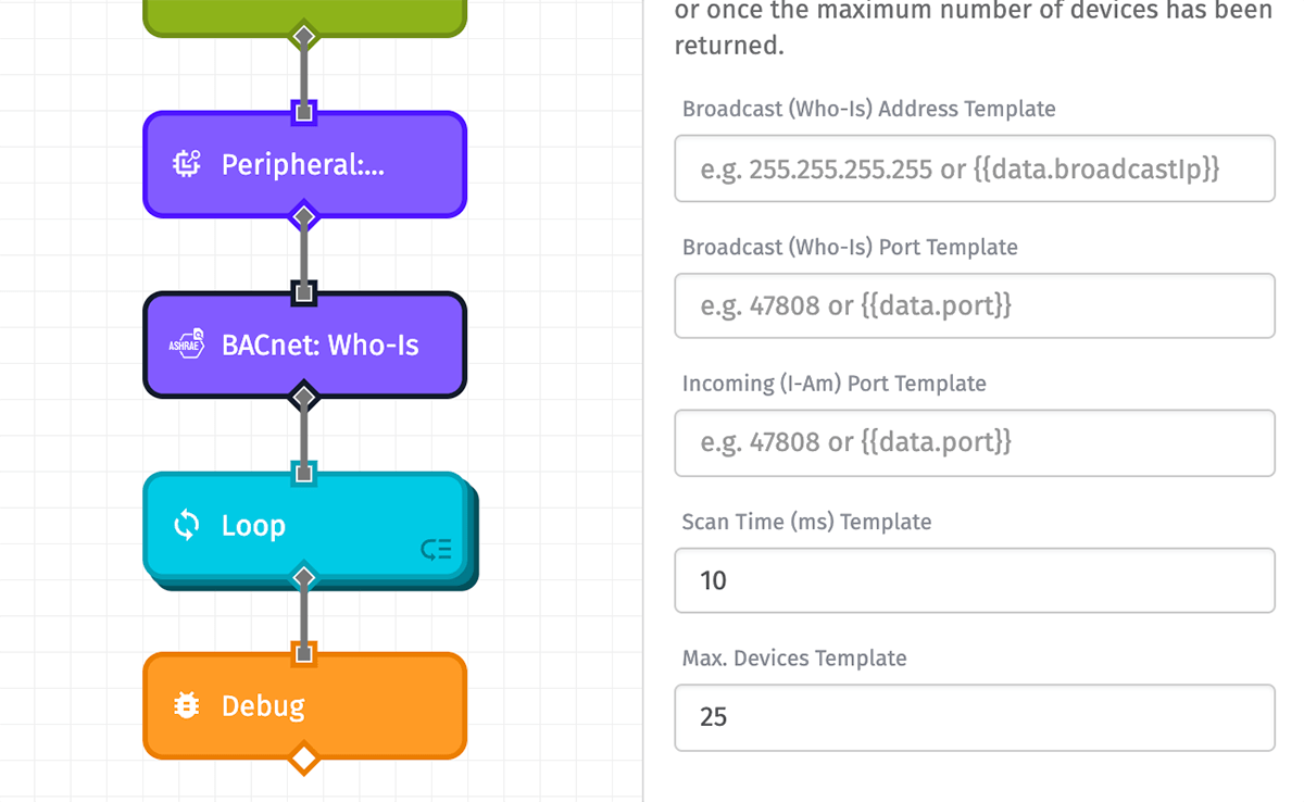

Network Scan Config
There are a handful of optional properties you may configure for broadcasting, listening for replies, and holding open the request. All of the properties accept string templates or direct inputs.
BACnet: Who-Is Scan Config
  • Broadcast (Who-Is) Address Template: By default, the broadcast message will go out on the standard broadcast IP of 255.255.255.255. However, you may specify a different address if necessary.
  • Broadcast (Who-Is) Port Template: The "Who-Is" broadcast will go out on the default UDP port of 47808 unless another port is specified.
  • Incoming (I-Am) Port Template: "I-Am" replies will be listened for on the default UDP port of 47808 unless another port is specified.
  • Scan Time (ms) Template: By default, the node will pause workflow execution for 30 seconds (30000 milliseconds) to await "I-Am" replies to its "Who-Is" broadcast. You may optionally specify a different length of time in milliseconds. (Note: The specified time must be less than the agent's MAX_EXTERNAL_CALL_TIME configuration option.)
  • Max. Devices Template: You may optionally specify a maximum number of devices to return. If the maximum number of returned devices is met before the scan time reached, the node will complete execution early and continue the workflow run.

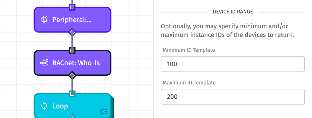

Device ID Range
Optionally, you may set a minimum and/or maximum ID for the devices to return. Both must be integers greater than 0 (or templates resolving to such values). If both a minimum and a maximum are provided, the maximum must be greater than the minimum.
BACnet: Who-Is ID Range

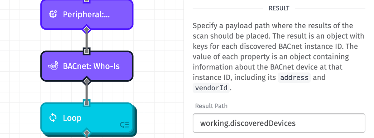

Result
Finally, enter a payload path for where the result of the operation should be placed. The result will be an object with keys for each discovered BACnet instance ID. The value at each key is an object containing the device's address, vendor ID, and other information.
BACnet: Who-Is Result
In this example, we assume that the BACnet: Who-Is Node received two "I-Am" responses from devices with instance IDs of 6 and 7, resulting in an object placed at the defined Result Path of working.discoveredDevices ...
"discoveredDevices": {
"6": {
"address": "192.168.2.56",
"port": 47808,
"forwardedFrom": null,
"vendorId": 5678
"7": {
"address": "192.168.2.57",
"port": 47808,
"vendorId": 6789
