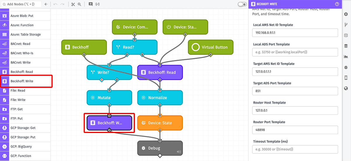

Configuration for the Beckhoff: Write Node is broken up into three sections ...
Connection Configuration
First, define the properties needed to establish a connection to the Beckhoff PLC. All of the following properties support string templates.
  • Local AMS Net ID Template: A six-octet address of the local device (running the GEA) in the TwinCAT network. This is usually the IP address assigned to the GEA device plus .1.1.
  • Local ADS Port Template: The port over which the ADS communication protocol of TwinCAT is exposed. Defaults to 37250.
  • Target AMS Net ID Template: A six-octet address of the target ADS device, usually defined on the device itself. Usually it is the IP address of the ADS device plus .1.1.
  • Target ADS Port Template: The target runtime ADS port. Defaults to 851.
  • Router Host Template: The hostname or IP address of the TwinCAT router.
  • Router Port Template: The port over which the TwinCAT router is exposed. Defaults to 48898.
  • Timeout Template (ms): The length of time, in milliseconds, to wait for a response before timing out the request. Default is 30000 (30 seconds), or the value of the MAX_EXTERNAL_CALL_TIME environment variable, if set.
