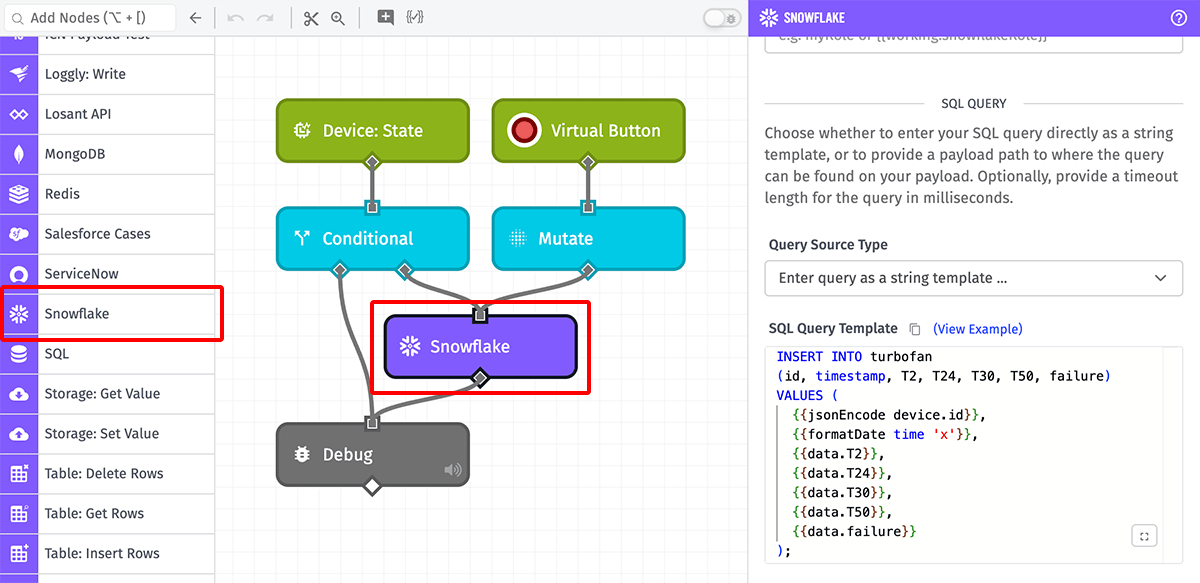

Query
With a database selected, provide a query to run against it. The query may be provided one of two ways ...
  • Enter query as a string template ...: If selected, enter your SQL query directly. The query may use string templates to reference values on the payload.
  • Provide a payload path to the query ...: If selected, provide a payload path to where the query string is stored on your payload.
Optionally, you may also provide a Timeout Template, which is a string template resolving to a maximum query duration, in milliseconds, before the request times out. If not provided, this defaults to 30000 (30 seconds) - or, in Edge Workflows, the value of the MAX_EXTERNAL_CALL_TIME environment variable.

Inserting Rows
Given the following SQL query, which inserts a row into a table called turbofan ...
INSERT INTO turbofan (id, timestamp, T2, T24, T30, T50, failure)
VALUES (
'{{device.id}}',
{{formatDate time 'x'}},
{{data.T2}},
{{data.T24}},
{{data.T30}},
{{data.T50}},
{{data.failure}}
The Snowflake Node places the following object on the payload at the specified path ...
"rows": [
"number of rows inserted": 1
