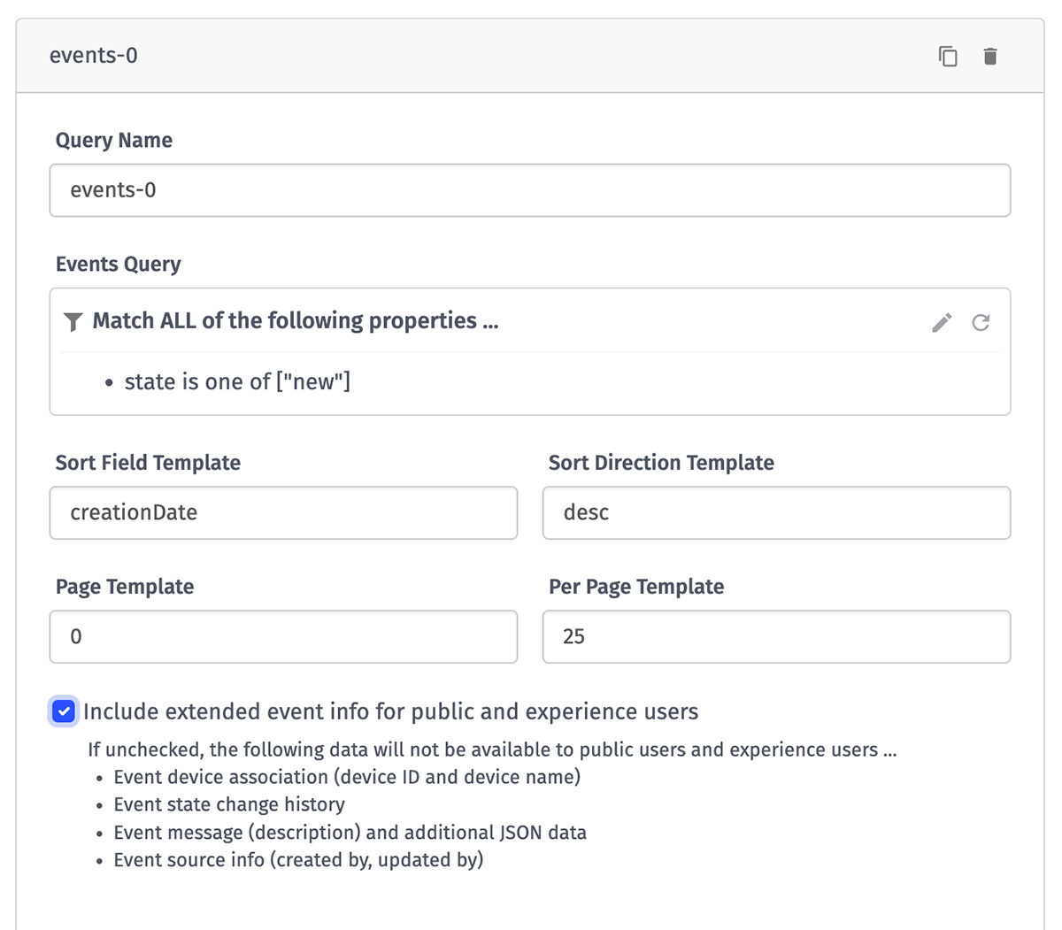

Event Info Query
The parameters of the Event Info Query include:
  • Query Name is what will be referenced in your block’s JavaScript code.
  • Events Query is an advanced query for choosing which events you want to access.
  • Sort Field Template is the property on the events to sort by. By default, this field is creationDate. The following are the valid sort fields: id, subject, level, creationDate, or lastUpdated. This field is templatable.
  • Sort Direction Template is the direction the sort field sorts in. By default, this field is desc. The valid sort directions are asc and desc. This field is templatable.
  • Page Template is the number of results to skip by multiplying this number by the Per Page Template field, allowing you to paginate through large numbers of events. This number must be greater than 0, and the default is 0. This field is templatable.
  • Per Page Template is the maximum number of events to return with one query. The max number of events that can be returned at once is 1000. The default is 25. This field is templatable.
  • Include extended event info for public and experience users, if checked, returns additional information about each event as described above.
