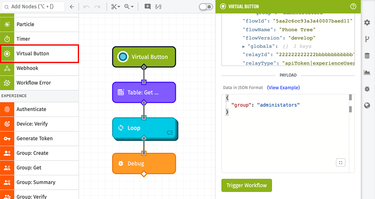

The Virtual Button Trigger Node will fire a workflow when the “virtual button” is pressed. The most common use case of the virtual button is to debug and test workflows, without having to wait for an external trigger of some kind.

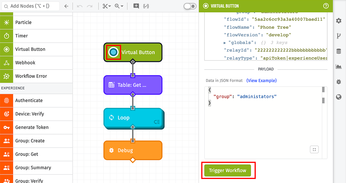

Triggering The Workflow
A workflow can be triggered by the virtual button in one of two ways. Either press the “Trigger Workflow” button in the node settings panel, or press the button on the node itself.

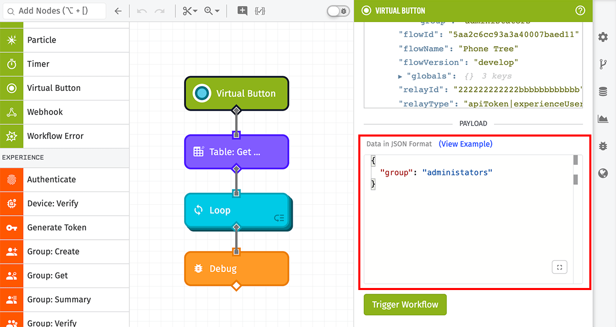

The Virtual Button Trigger Node can be configured to have a specific payload sent when the button triggers the workflow. This payload must be a valid JSON object, and will be placed on the standard data field of the payload when the workflow runs. The payload field can be left empty, in which case an empty object is used as the payload.
Virtual Button Trigger Config
In the above example, the workflow will run with the data payload of {"power": "toggle"}.
